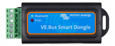

The VE.Bus Smart dongle is a Bluetooth Smart enabled VE.Bus interface, with battery temperature-and-voltage sensing. It communicates system information straight to your smart phone - using the free-to-use VictronConnect app.

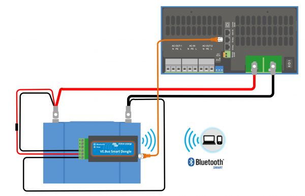

Installation without battery sensor:
- Connect the red connection wire to the B+ input on the connection block
- Connect the black connection wire to the B- input on the connection block
- Connect the two eyelets to your battery terminals. Red wire eyelet on bat+ , black wire eyelet on bat-
- For battery temperature sensing, mount the dongle on or near the battery using the dongle's adhesive mounting. If mounted near the battery, screws can be used.
- Plug the connector block into the dongle.
- Connect the dongle to the Multi's Ve.Bus interface, using a standard RJ45 UTP cable
Installation with battery terminal temperature sensor:
The battery temperature sensor replaces the included red battery(+) connection wire.
- Connect the temperature sensor's red connection wire to the B+ input on the connection block
- Connect the temperature sensor's black connection wire to the T- input on the connection block
- Connect the two eyelets to your battery terminal. Red wire eyelet on bat+ , black wire eyelet on bat-
- Mount the dongle on or near the battery using the dongle's adhesive mounting. If mounted near the battery, screws can be used.

Ve.Bus Smart has two LEDs: a Bluetooth status LED (blue), and an Error LED (red).
On power-up, the Bluetooth LED will be slow-blinking - indicating that the device is ready to accept a Bluetooth connection.
If both LEDs remain illuminated, something is wrong with the Ve.Bus Smart unit (Hardware error).

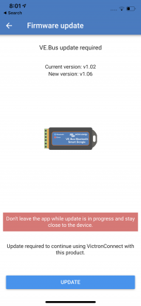

When the LEDs are alternating quickly for more than 30 seconds, the Ve.Bus Smart is in firmware update mode and will need to complete the update before it can be used. Firmware updates are performed (where necessary) after connecting to VictronConnect.

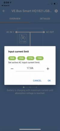

Victron Connect Screenshots
