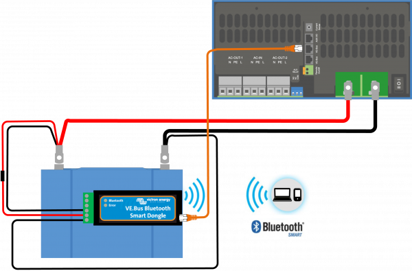

Installation without battery sensor:
  1. Connect the red connection wire to the B+ input on the connection block
  2. Connect the black connection wire to the B- input on the connection block
  3. Connect the two eyelets to your battery terminals. Red wire eyelet on bat+ , black wire eyelet on bat-
  4. For battery temperature sensing, mount the dongle on or near the battery using the dongle's adhesive mounting. If mounted near the battery, screws can be used.
  5. Plug the connector block into the dongle.
  6. Connect the dongle to the Multi's Ve.Bus interface, using a standard RJ45 UTP cable
Installation with battery terminal temperature sensor:
The battery temperature sensor replaces the included red battery(+) connection wire.
  1. Connect the temperature sensor's red connection wire to the B+ input on the connection block
  2. Connect the temperature sensor's black connection wire to the T- input on the connection block
  3. Connect the black connection wire to the B- input on the connection block
  4. Connect the two eyelets to your battery terminal. Red wire eyelet on bat+ , black wire eyelet on bat-
  5. Mount the dongle on or near the battery using the dongle's adhesive mounting. If mounted near the battery, screws can be used.
  6. Plug the connector block into the dongle.
  7. Connect the dongle to the Multi's Ve.Bus interface, using a standard RJ45 UTP cable
