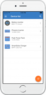

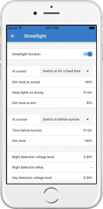

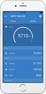

With the VE.Direct to Bluetooth Smart dongle you can get live status info, see historical values as well as configure Victron products.
The dongle works together with the VictronConnect App, available for both Android and iOS devices.
