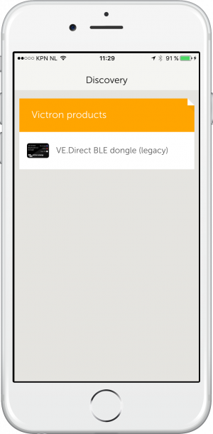

I don't see my product in the discovery screen
- Only one phone or tablet can be connected to a dongle at the same time. Make sure no other devices are connected to the dongle, and try again.
- The dongle does not support all Victron products. Check if your Victron product is listed in the section above.
- The dongle is powered via the VE.Direct cable connection. Make sure the dongle is connected to a supported device and the LEDs blink when connecting the cable or power is turned on.

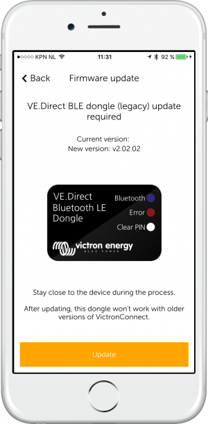

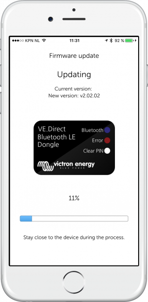

Update dongle firmware

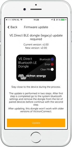

After connecting with a new VictronConnect version for the first time, it might be that the firmware of the dongle needs to be updated. Be warned that this dongle firmware update can be a bit of a hassle: all steps need to be patiently and accurately followed.
The update might need multiple steps: repeat the process untill the dongle entry disappears from the list and the product connected to the dongle is listed instead.
There are small differences between the Android and iOS update process.
If you get stuck in any point of the update process just close and open the app again. That should reset the update process to the last completed step.

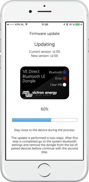

iOS
- The dongle has to be paired before starting the update.
- After the first update step is completed go to the iPhone/iPad bluetooth settings and remove the dongle from the paired devices list. Then go back to the VictronConnect app and continue with the second step.
At this stage go to the iPhone/iPad bluetooth settings and remove the dongle from the paired devices list:
