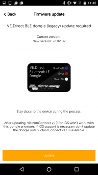

After connecting with a new VictronConnect version for the first time, it might be that the firmware of the dongle needs to be updated. Be warned that this dongle firmware update can be a bit of a hassle: all steps need to be patiently and accurately followed.

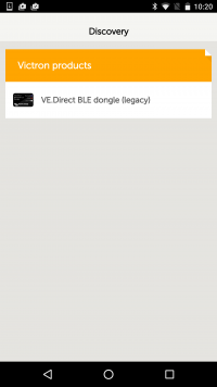

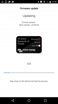

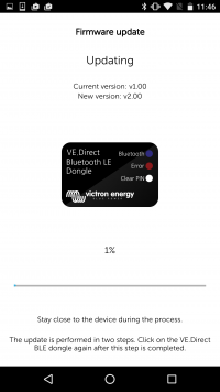

Connect your dongle to any Victron product VE.Direct port, open the VictronConnect app and click on the listed dongle and follow the steps shown on the screen.
The update might need multiple steps: repeat the process untill the dongle entry disappears from the list and the product connected to the dongle is listed instead.
There are small differences between the Android and iOS update process.
If you get stuck in any point of the update process just close and open the app again. That should reset the update process to the last completed step.

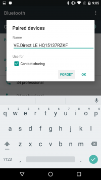

  1. The dongle has to be unpaired so check your phone/tablet bluetooth settings and remove it from the paired devices list if is on it. Don’t pair the dongle during the update process even if you’re asked for the PIN code just close the dialog.
