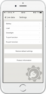

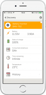

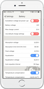

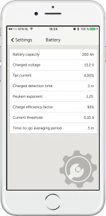

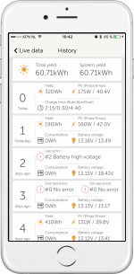

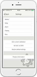

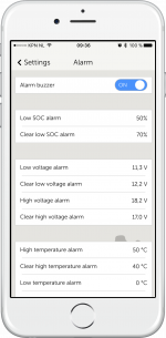

Example screenshots, click to enlarge:
VictronConnect - Discovery VictronConnect - BMV VictronConnect - BMV settings VictronConnect - BMV alarm settings VictronConnect - BMV battery settings VictronConnect - Info
VictronConnect - MPPT VictronConnect - MPPT settings VictronConnect - MPPT battery settings VictronConnect - MPPT streetlight settings VictronConnect - MPPT history

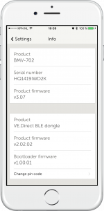

After connecting, you can change the pin code by pressing the (i) button in the top right of the app.
If the dongle pin code is lost, reset it to 000000 by pressing and holding the clear PIN button until the solid blue colored Bluetooth light flashes off and on momentarily.

Update dongle firmware
After connecting with a new VictronConnect version for the first time, it might be that the firmware of the dongle needs to be updated. Be warned that this dongle firmware update can be a bit of a hassle: all steps need to be patiently and accurately followed.
Connect your dongle to any Victron product VE.Direct port, open the VictronConnect app and click on the listed dongle and follow the steps shown on the screen.
The update might need multiple steps: repeat the process untill the dongle entry disappears from the list and the product connected to the dongle is listed instead.
