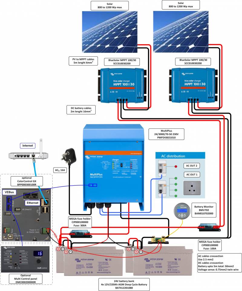

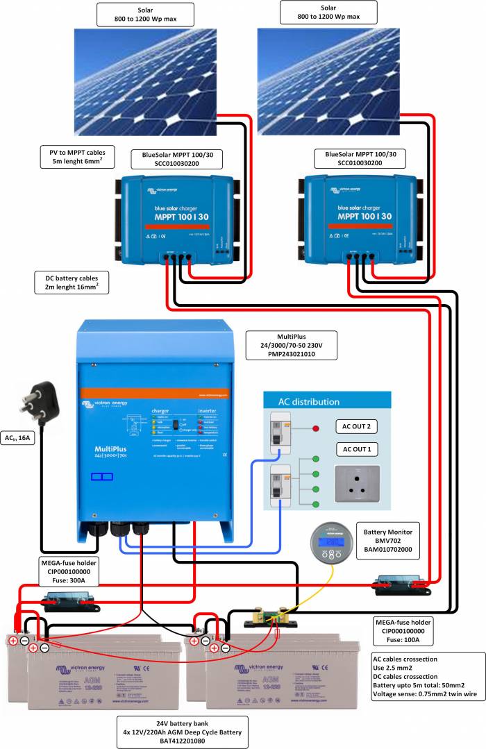

Simple system
The basic system consists of only 2 parts:
- MultiPlus
- Batterybank
- 2 MPPT solar chargers
- BMV702
Connect the AC input to the mains. Connect the AC to the loads you want to backup.
Connect the battery cables to the battery. Read the manual for details on how to safely connect the batteries.
Verder uitwerken!!
Parts
- 1x - PMP243021010 - MultiPlus 24/3000/70-50 230V VE.Bus Inverter/Charger
- 4x - BAT412201080 - 12V/220Ah AGM Deep Cycle Battery
- or - BAT412201100 - 12V/220Ah Gel Deep Cycle Battery
- 4x - Battery link cables
- 2x - MPPT Solar Charger
- ??x Panelen (Victron panelen erbij?? Welke dan??)
- 1x - BMV702
Advanced system
When you want to have a better idea of what your system is doing some optional parts can be installed.
For simple monitoring and remote on/off switching the Digital Multi Control can be used. This is installed using 1 network cable. This can be used to turn the Multi on and off and to see the operational state.
If you want to do more advanced monitoring or even logging and remote monitoring you can install the ColorControl GX. This is a graphical display which can connect to almost all Victron equipment and the internet. For more information and details see the product pages.
optional parts
- DMC000200000R - Digital Multi Control 200/200A GX
- BPP000300100R - Color Control GX
Plaatje nog aanpassen dat VEDirect is aangesloten en Battery Balancer toevoegen
