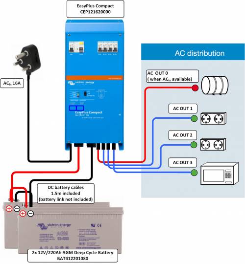

Parts
  • EasySolar 12/1600/70-16 MPPT 100/50 Inv./Solar Charger Combi: CEP121621000
  • Batteries: 2 pieces 12V/220Ah AGM Deep Cycle Battery: BAT412201080
  • or 2 pieces 12V/220Ah Gel Deep Cycle Battery: BAT412201100
  • Battery Monitor BMV700: BAM010700000
Nieuw plaatje

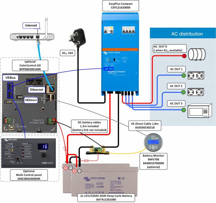

optional
  • Digital Multi Control 200/200A GX (90º RJ45) Retail: DMC000200000R
  • Color Control GX Retail: BPP000300100R
nieuw plaatje
How long is the backup time?
Explain what it solves:
  • Load shedding period: High power 1000W DoD 50% SoC about 2 hours
  • At night: Low power 250W DoD 50% SoC about 8 hours
Notes for batteries:
  • We recommend deep-cycle GEL or AGM batteries. At least 200Ah per block.
  • Cable cross section: xxxx mm2 MCO: welke mm2 / stroom rating welke lengte
VE.Configure Settings
plaatjes toevoegen!!
  • Disable overrule by remote
  • Change DC input low shutdown to 10.8 volts
  • Change DC input low restart to 11.8 volts
  • Change DC input low pre-alarm to ??.? volts
  • Charge current can be left at standard setting.
  • Enable battery monitor and set correct Battery capacity
