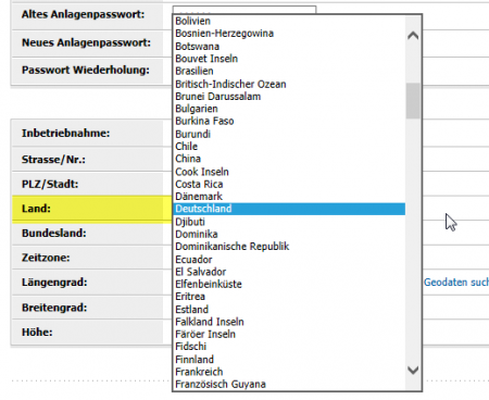

Selection for native language
The language of the VRM portal is English. In Germany we have a lot of customers, which want to see their system in their native language, because they speak no English. We would like to have a localization selector box in the settings. If you need the German translation - no problem, I can do that. Example:
**MVA: is being done at this moment. **

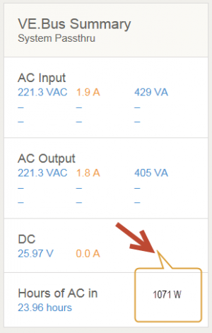

Missing DC power on "Advanced" tab
There is a VE.Bus summary table on the right side. AC input and output are shown. In the 3rd row the DC voltage and current are shown. It would be fine, if the DC power (Voltage x Current) will be displayed, too. Just like AC input and output.
**MVA: Good idea, we will add that. **

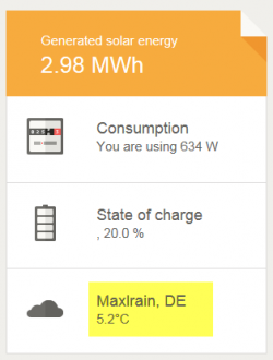

Weather location is changing without altering the GPS coordinates
At the setup of my system in VRM portal I typed in the GPS coordinates of my town Bad AIbling. In the tab “Live feed” different nearby locations are displayed, e.g. Tuntenhausen, Maxlrain (about 5 km away). Why is it changing automatically? From where do you get the weather data?
**MVA: Yes I have heard this more often. We'll find out if there is anything that can be done about it. **

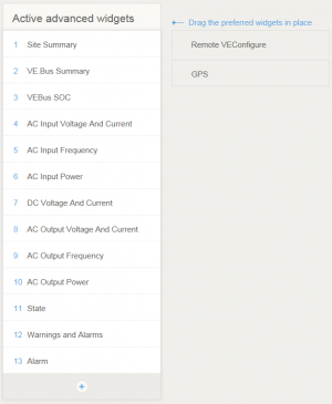

Settings - Create your site summary not working well
In the settings the shown widgets for the “Advanced” tab can be configured. You take a widget from the right side and drag it to the left table where it should be shown. After doing this, you have no possibility to drag a second widget to the left side. You have to save and the you can repeat it sometimes.
It seems, that the table on the left side is limited to a maximum of four widgets. I am not able to drag a fith one to the left. If I delete one on the left side, I can place another one.
It seems to be changed since yesterday. In the settings there are more possibilities:
But it is not displayed on the “Advanced” tab:
//Note from John Rushworth. My Yacht ELEKTRA site summary now working fine. I could drag individual widgets to a total of 4 or less and save when I had what I required. Mine now displays in “Advanced” tab, as below. //
**MVA: Andreas, can you try and let me know if this is still a problem? **
