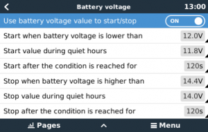

- Generator state: Condition that is currently keeping the generator running.
Settings
- Conditions: See Conditions
Conditions
- Periodic test run
Condition settings
Test run condition
Allows you to program a periodical test run.
- Test run interval: Test run will be performed periodically based on this setting
- Skip test run if has been running for: The test will be skipped if during the test run interval the generator was running at least the number of hours set on this setting.
- Test interval start date: The interval count will start based on this date, this setting can be set in the future and the interval will be ignored till the set date is reached.
- Start time: Time of day in which the generator will start
- Test duration: Duration of the test
