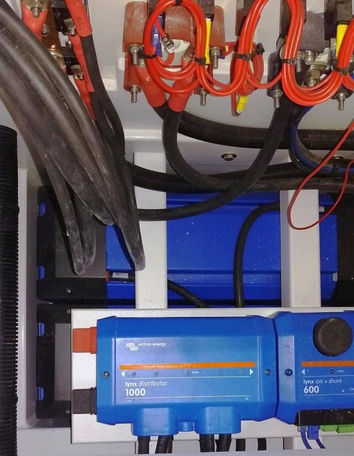

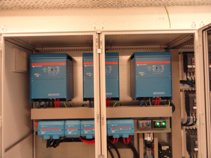

Customer Images
Here are some images from customer's installations that may help you to understand the installation of the Lynx System.
