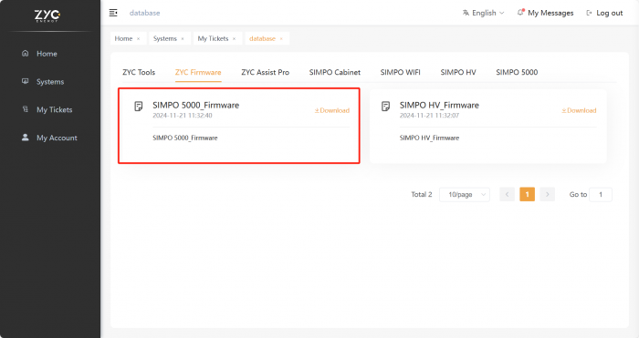

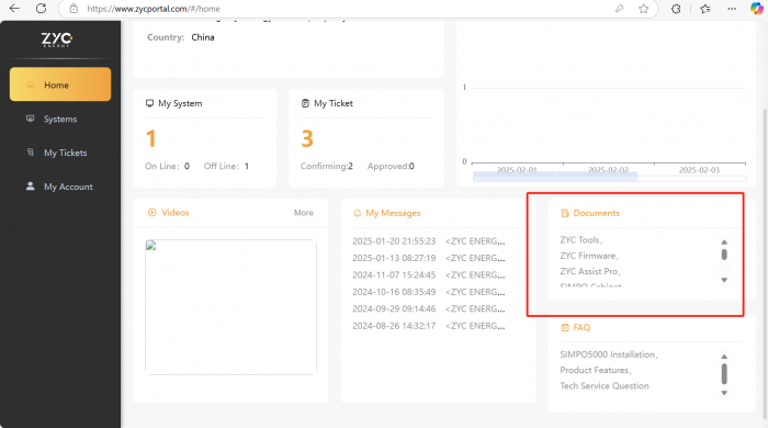

Victron does not store ZYC firmware files on VRM, nor does it know what the latest firmware version is, or if there is an update available. ZYC updates will need to be downloaded to your computer first from https://www.zycportal.com documentation section so that you can upload them via VRM.

Follow VRM’s on-screen instructions to initiate the firmware update, this involves uploading a firmware file obtained from ZYCs website. Wait for the process to complete.
