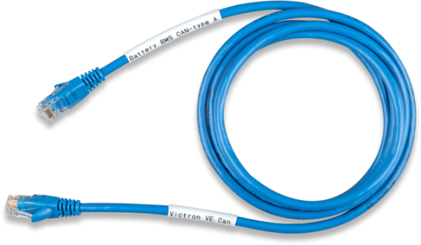

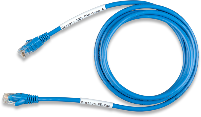

The HELIOS ESS supports direct closed-loop communication with a Victron GX device through the Victron VE.Can to CAN-bus BMS Type A cable.
Use the Victron VE.Can to CAN-bus BMS Type A cable for the direct connection. Its pin-out matches the HELIOS ESS COM2 port: COM2 pins 4 (CAN-H), 5 (CAN-L) and 6 (GND) connect to VE.Can pins 7, 8 and 3. A standard straight patch cable does not work for this connection.
1. Plug the cable end labelled “Battery BMS CAN-type A” into the HELIOS ESS COM2 port. Plug the end labelled “Victron VE.Can” into a VE.Can port of the Victron GX device. Insert a VE.Can terminator in the other VE.Can port of the GX device.
