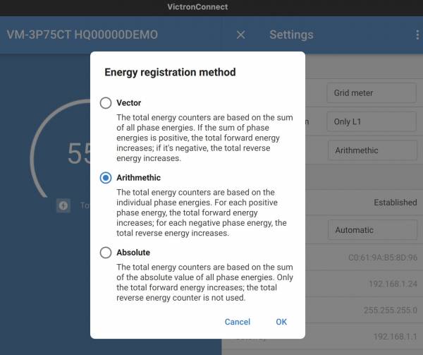

Phase Compensation (Sum/Vector Method): It is common for 3 phase grid utility meters calculate energy by summing all phases. If your meter does this, VRM (Victron Remote Management) should also show this summed (compensated) energy, or else there will be a discrepancy.
To show compensated energy on VRM, you must use a grid energy meter designed for this, such as:
Individual Phase Counting:
If your utility meter counts energy for each phase separately, VRM should show each phase individually (without compensation).
These meters count energy this way:
What VRM shows is determined by the type of meter used in the system, not by VRM or any other configurable setting on the GX device.
Understanding Phase Compensation
For VRM and optimal pricing accuracy, the energy counting method must match your utility's billing method.

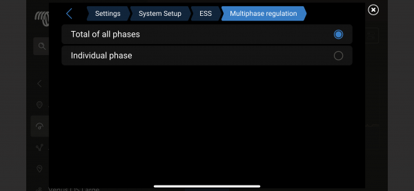

The Phase Compensation setting in the ESS menu affects system behaviour, not the energy counting method.
