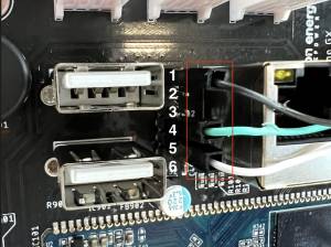

7.3 Venus GX
The serial console is located on the base-board, and can be accessed through the slot between that board and the Ethernet connector on the beaglebone-board.
Make sure not to connect the red wire.
Here is a picture showing how, also using the adafruit serial console cable as referenced above:

7.6 Ekrano GX
Getting to console on the Ekrano GX is not that easy. The pins are located between the network and USB connector on the back of the device.
  1. Black: ground
  2. NC
  3. NC
  4. Green: RX of the Ekrano GX - connect to TX on your cable
  5. White: TX of the Ekrano GX - connect to RX on your cable
  6. NC
