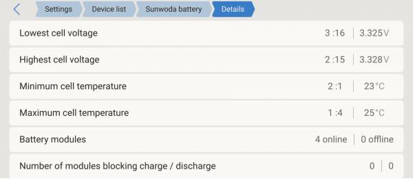

1.1 A GX device is required, eg Cerbo GX, etc
It is essential to use the BMS-Can (500 kbit/s) connection type of a GX device with these batteries for communication of charge and discharge limits, error codes and state of charge.
It is possible to use either the BMS-Can or VE.Can ports with this battery. Depending which one you use will require additional configuration on the batteries side, please see the documentation linked below for instructions.
The minimum supported GX firmware version is v3.60. It is recommended to use the latest firmware version on new installations and when trouble shooting issues.
The minimum supported Sunwoda firmware version is V1.11.
Connecting a Sunwoda battery to the GX device will automatically enable DVCC, and disable SVS and STS.
The Sunwoda battery automatically controls the target voltage on the Victron system (CVL). When actual battery voltage exceeds 54.5V, the CVL will begin to decrease. Sunwoda battery cells will balance themselves between 2900mV~3600mV.
